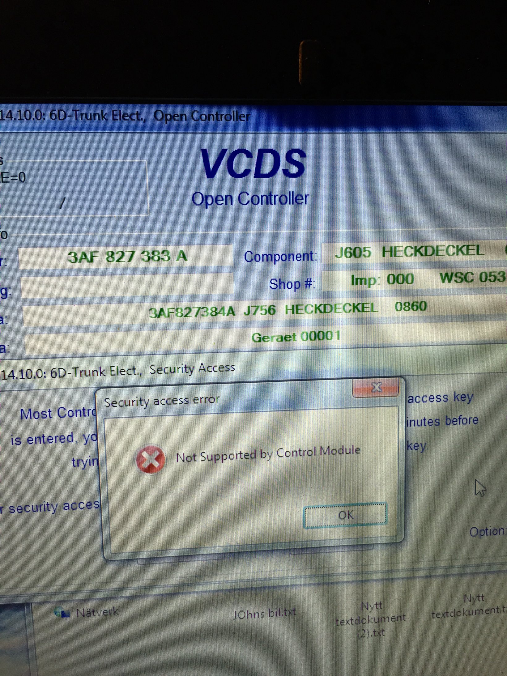

Jag kom inte åt modulen med "säkerhetskoden" 12345?
Bifogad fil 5336
Jag kollar närmare på detta med VCDS.
It sounds like you are trying to use a Security Access code for a Skoda
Superb hatch, which has a different type of 6D-Trunk Electronics module
than this car. We are not aware of an applicable Security Access for
your module but we can look into it.

Hoppas du hittar en lösning
Det ser mörkt ut tyvärr!
"Thanks for the files. They should help us to improve documentation in
future versions of VCDS.
Unfortunately we have not found any information on operating the hatch
remotely or coding variations for trailer."
